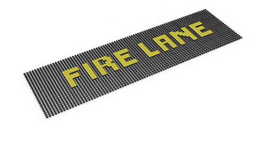

Just for fun (I really need to get a life) I imported a fileI'm working on which is a complex moulded part that clips togetherto make a "carpet" of the same components. I did a pattern array of16x8. The polygon count on the PhotoView model was 12 million.Render time at HD resolution (1920 x 1080) was just under 14minutes. No crashes.
Impressive
As an aside this assembly also showed up the fact that in SW2009the assembly performance and display is far far better than 2008.The bounding box display when rotating is much more intelligent.
It also showed that PhotoView used the saved configuration OK, andit recognised assembly level features like cuts. Which is somethingHypershot doesn't do!SolidworksPhotoview 360
