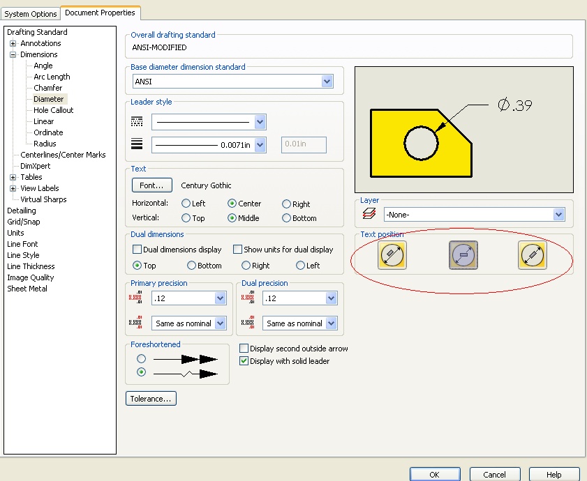

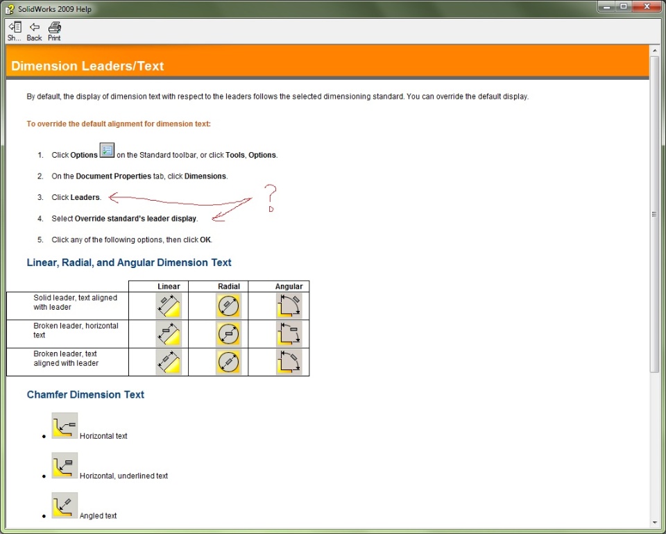

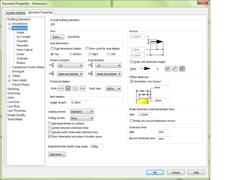

Using SW2009, I still have to doctor any radius dimensionwhere the text is outside the radius.
The arrow is outside the radius as required but the annoying linefrom the radius to its centre is still present and every time Ihave to click the leaders tab and click the Open Leader icon to getrid of the inner line.
Is there any way I can set it as a default to not show thisline?SolidworksDrawings And Detailing
