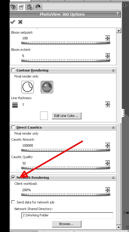

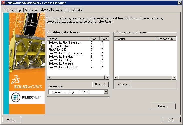

Looks like SolidWorks forgot to add the PV360 Network Render license's to the License Server.

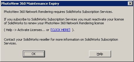

No testing for me until this is resolved.  SolidWorks thinks that I am not on maintenance when I select Network Render in the PV360 options.  It is asking me to activate my install.  Nothing to activate when installing since I am using a license server.
This is on the master machine.  The clients are running just fine.
I am rendering an animation in the Motion Manager.
