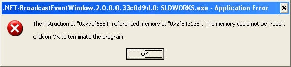

Actually, SolidWorks is working like a charm, including theVarBoxpackage. However, after I exit SolidWorks I get the followingerror(Also attached screenshots):
.NET-BroadcastEventWindow.2.0.0.0.33c0d9d:SLDWORKS.EXE- Application Error
The instruction at "0x77ef6554" referenced memoryat"0x2f843138". The memory could not be"read".
Click on OK to terminate the program.
or:

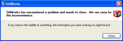

SldWorks
SldWorks has encountered a problem and needs to close. We aresorryfor the inconvenience.
If you where in the middle of something, the information youwereworking on might have been lost.
This only happens if I have added a part from the VarBoxdatabaseinto the model. If I just browse the VarBox database andexitwithout adding anything into the database, nothing happens whenIgo out of Solidworks.
This also appears under Application in the Event log:
