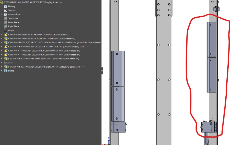

I have a sub assembly that is fully constrained.  It is up to date, with no warnings or errors.  There is one configuration and one display state.
When I open this subassembly in the parent assembly, the parts are in the wrong position.  (The "lock rotation" constraint is applied 180 degrees off.)
I've had this problem off and on since 2018, although the symptoms are sometimes different.
Any ideas on what I'm doing wrong, or how to fix it?
Sub assembly:
Parent assembly:
The parts in question are located with a concentric mate, with lock rotation turned on.

Is the sub-assembly in the "Flexible" mode?
SP
SP 2019-11-12
Yes.  The work around was to make the sub assembly rigid (which fixed the alignment problem) and then change it back to flexible.

You say the "Lock Rotation" constraint is applied 180 degrees off, what are you referring to??
It looks like the mates could be flipping?
Or..
Do you have more than one configuration??
SP
SP 2019-11-12
In my original post I state there is only one configuration.
The two parts each have 2 mates.  A surface to surface coincident mate, and a bolt hole to bolt hole concentric mate.  It is the top hole on both parts, so if you removed the "lock rotation" and rotated them 180 degrees, you would see what appears in the parent assembly.
My assumption is that the mate is flipped, but there was a time in the process where the parts were in the position shown in the parent assembly.  I guess it is possible that somehow the parent assembly is looking at a previous iteration of the sub-assembly, but I'm not sure how that could happen.
