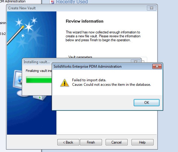

if you have installed Enterprise PDM 2013 Beta2 and try to set up a vault with the official 2013 what's new demo kit (from the Var Resource Center), it will likely fail with the following error when importing the "WN 2013.cex" export file:
This happens because the export file was created based on 2013 Beta1 format and the updates made between Beta1 and Beta2 will cause Beta1 exports to fail importing.
As a workaround, please use attached 2013 Beta2 export file instead (WN 2013 Beta2.cex).
