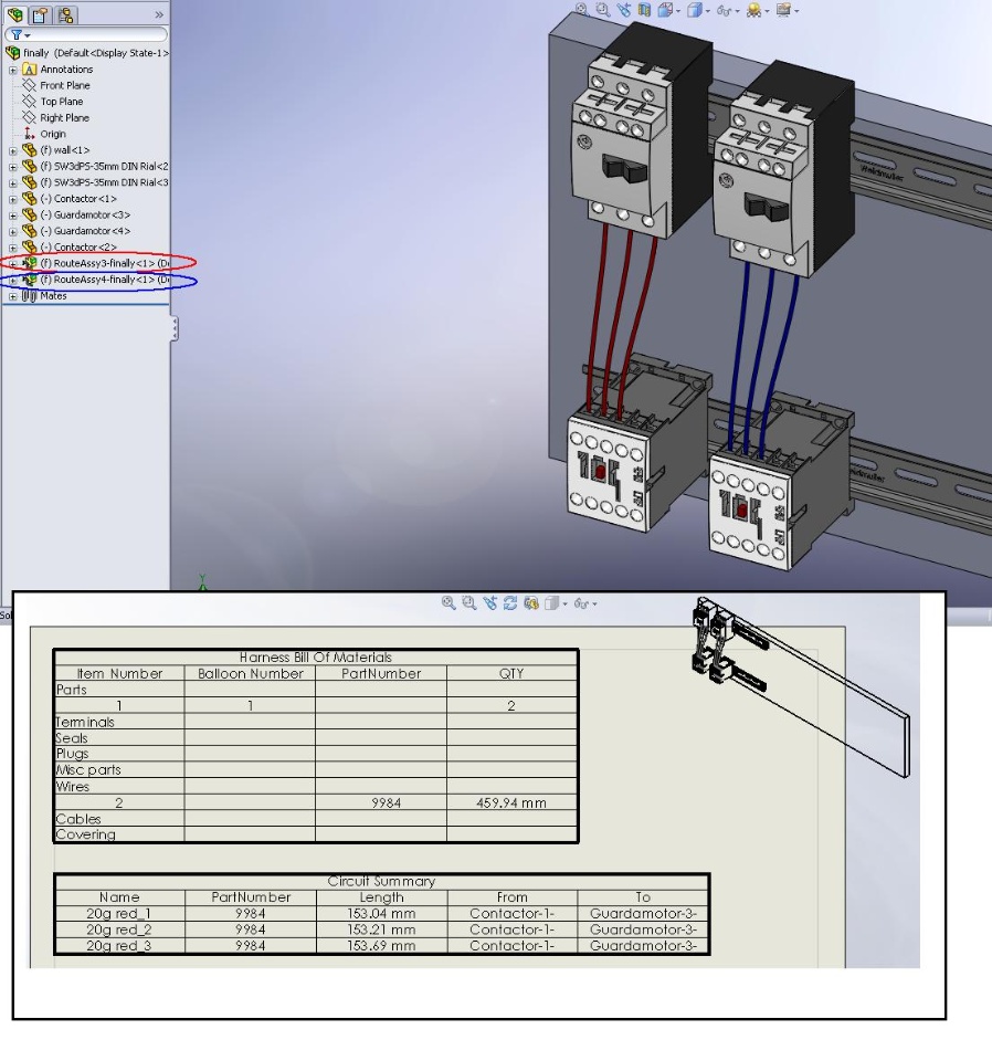

I have had extreme frustration trying to create wiresummaries (a harness BOM and Circuit Summary) of my routing. Youcan see from the attached picture, I have just created my parts(ready for routing) and performed a routing of the electrical wireson both of them. There are 2 groups of 3 wires, and both of thegroups were created in a separate routing assembly--one red and oneblue.
I then go to the drawing and go toRouting-->Electrical-->Harness-->Reports and checkeverything and it creates for me the Harness BOM and CircuitSummary. Everything looks fine except that it only includes onlythe summary of the first routing assembly (the red wires).
I would really like a summary of all the wires (red and blue) andtheir lengths. I'm sure this has to be possible. What am I missing?any advice will be appreciated.
