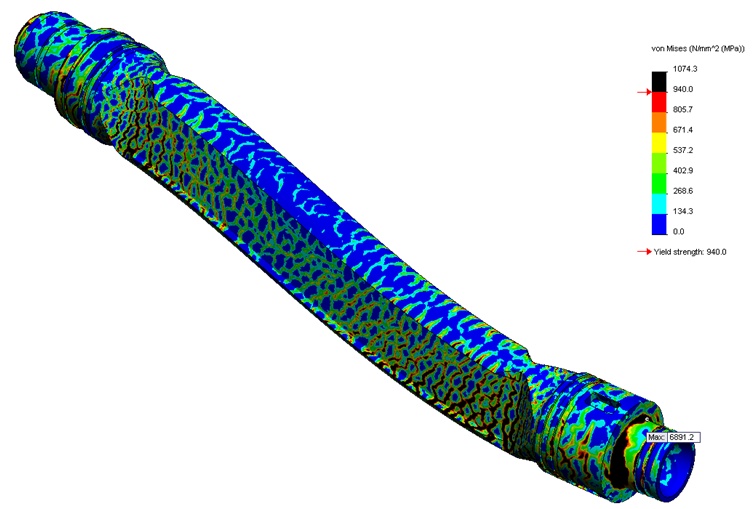

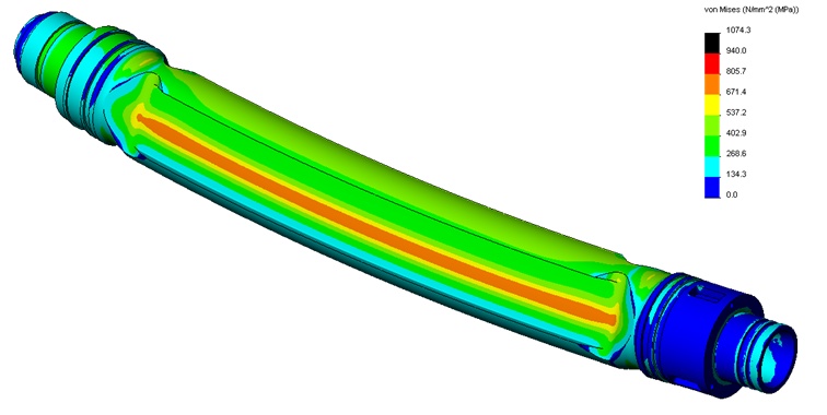

Ø4.6" x 42" cylinder with a number of machined features, supported at one end and subjected to a 0.7° bend (using a remote displacement) at the other.  Unfortunately, the results generated were spectacularly out of line with what had been seen previously.  Here is the result from SW2009:
And here is the result from SW2011:
As I'm sure you can appreciate, quite the difference!

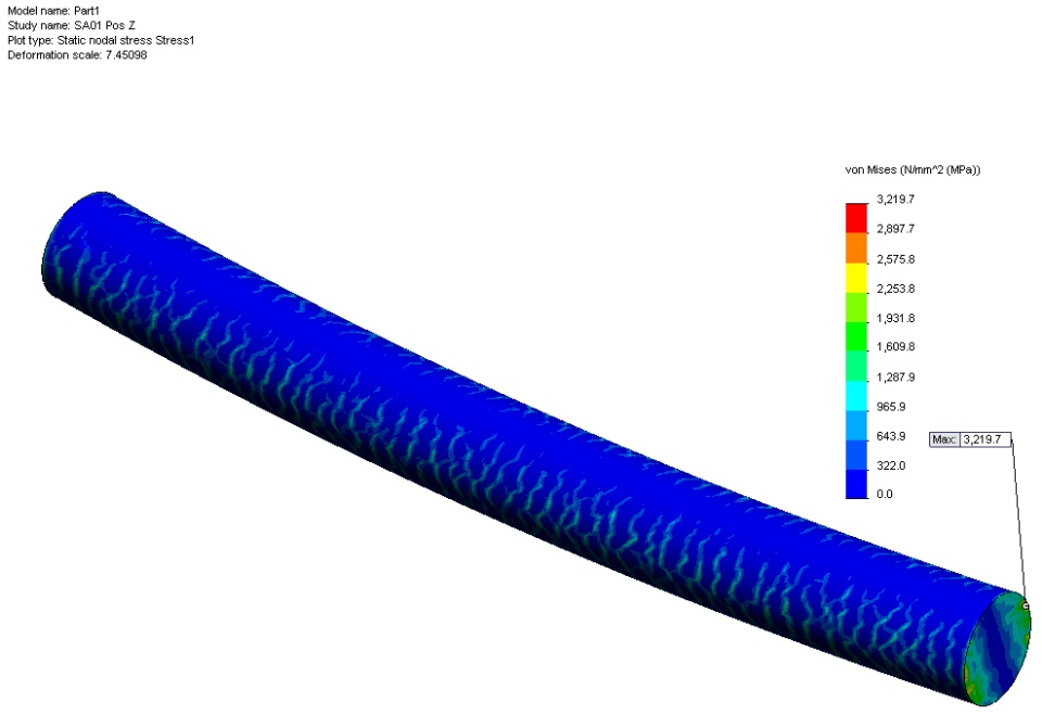

As an attempt to solve this issue, I decided to go back to basics and analyse about as a simple a part as is possible - a

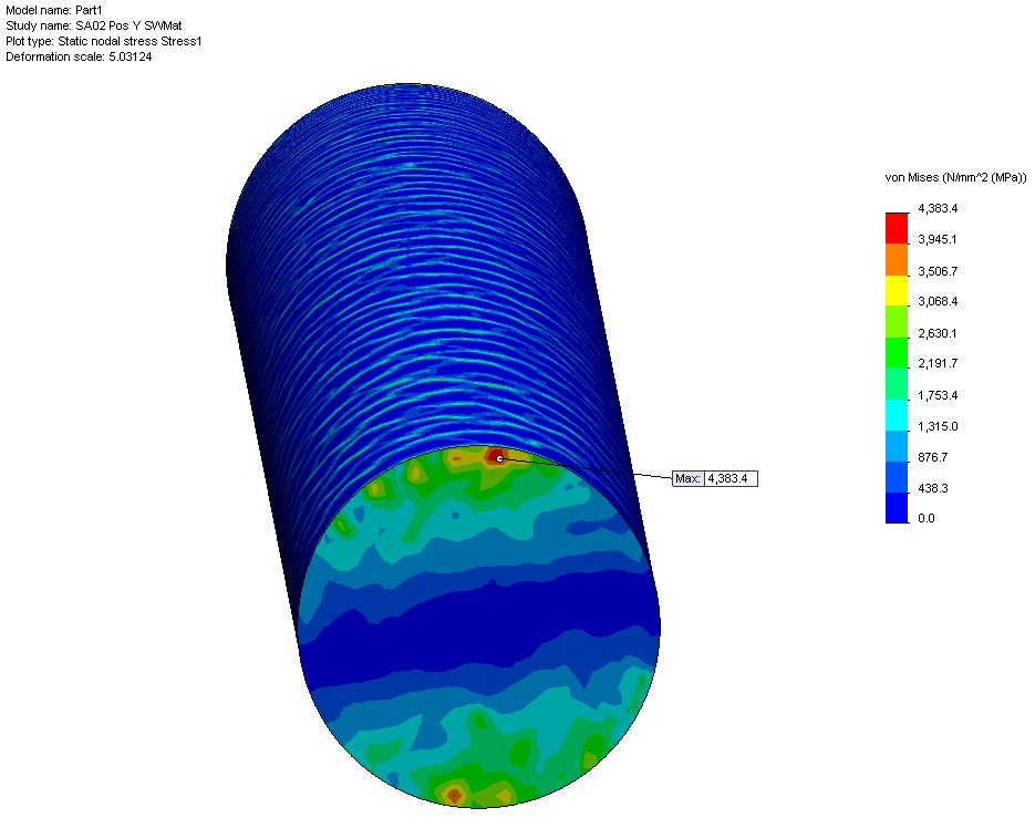

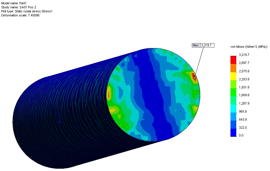

Ø2" x 20" solid bar.  This bar had a fixed restraint applied at one end, and a 0.45° bend at the other.  For the first test, the bar was bent in the positive direction around the Z-axis (assuming that SW2011 follows the right-hand-rule convention for bending used in SW2009).  When viewed from the right, a deflection upwards would be the expected result, however this was in fact the result generated  (note - the material applied was the stock SolidWorks "Alloy Steel"):
While not only being in the wrong direction, this analysis also yielded the same tropical-fish-like pattern along the part:

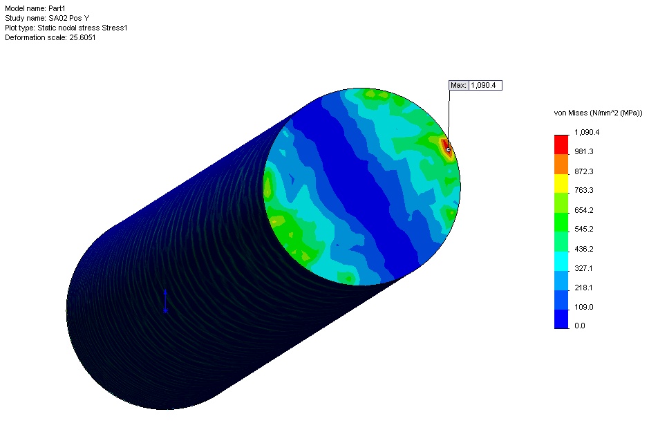

I then proceeded to try and bend the part around the Y-axis - if this was perpendicular to the Z-axis bend (as it should be), I felt I would at least have something consistent to work from when trying to find the root of the problem.  However, this bend around the Y-axis generated the following deflection:
ie. nothing like perpendicular to the Z-axis!  And again with the unexpected patterning along the body.
As another check, I changed the materials to one of our company-defined property sets.  The bend direction should be fixed regardless of the properties of the material, however the following picture shows the bend in what is theoretically around the Y-axis:
Once again, this is not deflecting in the correct direction, however more concerningly it is not even consistent with the earlier Y-axis defection!

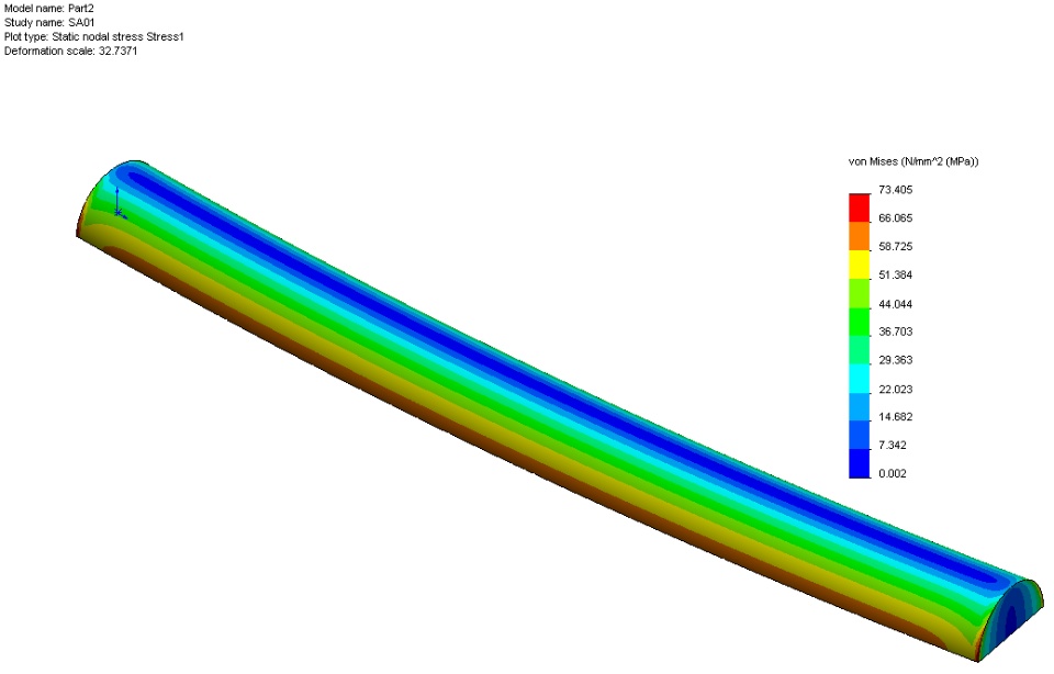

Finally, I split the model in half and applied a symmetry restraint to see if this would make a difference.  Surprisingly enough, it did:
The stress plot here is exactly as you would expect for this specimen - maximum stress along the edges that see compression and tension, and minimal stresses along the neutral axis.  So it would appear that somewhere in the system the bend feature is working, but only if what you're analysing is symmetrical (which our products rarely are) and is only any good if your worst-case bend direction is along the axis of symmetry (which our products never are!).
