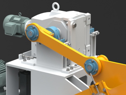

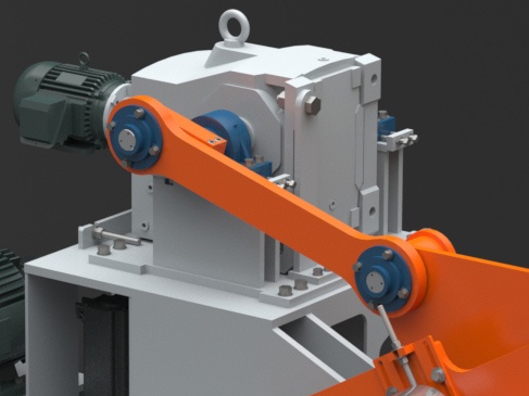

So I picked an assembly, coloured it with my RAL paint colours (sRGB values), set Gamma to 2.2, setup a scene light with a camera and hit render. Wow really unimpressed. The colours were way off!  Most notably the RAL 2009 Traffic Orange, RAL 5001 Green Blue, RAL 6012 Black Green and RAL 7040 Window Grey.  Now I tried the default gamma of 1.6 and adjusting the lighting but no matter what I did the colours didn't look correct.
After doing some more research I discovered that I could use Modo materials within PV360.  I downloaded the RAL colours from foundry.com and brought them into SW.  First thing I noticed was the message saying that the colours in the viewport would be darker (can't remember the actual message).  Changed out the appearances, hit render and wow, WAY better.  These look like the correct colours. (don't have a render).
So this got me thinking about sRGB and Linear RGB.  Maybe SW doesn't have a way to display a sRGB colour but use a Linear RGB for rendering.  Thus I manually converted all my sRGB values to Linear RGB and reapplied my appearances.  This resulted in VERY dark colours in the viewport that don't look correct..  Hit render and voila the render looked almost identical to the Modo appearances.
