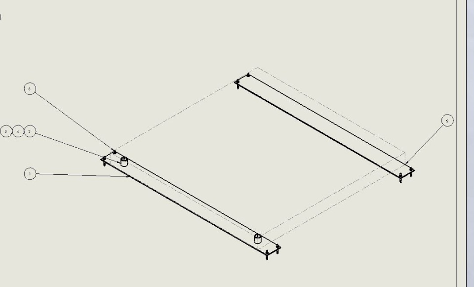

An example of the way I get around this now... say I have a couple of lagged down plates locating a pallet of some sort:
This is a simple assembly.  I could show everything in my iso view, except I don't want the hidden lines on the reference pallet (I realize it wouldn't clutter that much in this case; but for the sake of my point, imagine this is a much busier piece of reference geometry).  I want to view through the reference geometry and simply show everything behind it, while retaining a basic outside hidden lines removed view of the reference pallet.
The way I do this right now is...
A. set the component to a phantom layer (as I show in the above pic).

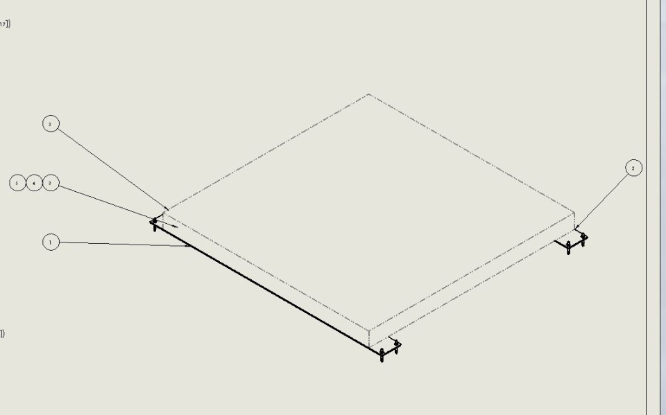

B. Copy the view off to the right.
C. convert the view to a sketch.
D. Delete the stuff in the sketch that isn't on my phantom layer.
E. Block the sketch of the phantom item, picking a reference corner somewhere.
F. Mark the reference corner of the item in the main view I want to keep.
G. Hide the phantom item in the view I want to keep.
H. insert the block of the phantom sketch into the view I want to keep, snapping it to the reference point (depending on what layer is active, I may also have to set the block to the correct phantom layer).
In the end I accomplish what I'm going for, which is this:
Its not that impressive here I realize, but when you have a much more complicated product and/or much busier tooling you're trying to show, it can be a very useful way to avoid the hassle of creating more drawing views.
