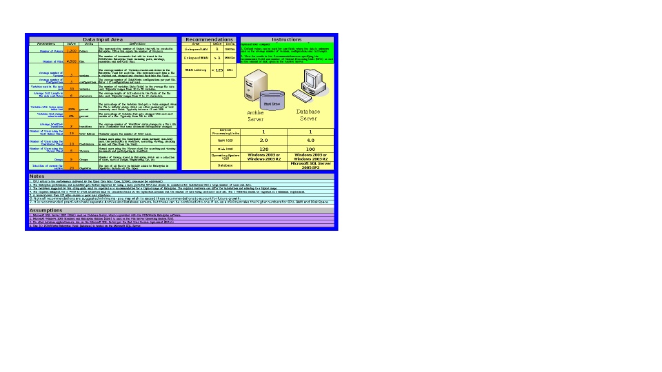

I.'m looking at the requirements for Enterprise PDM and SW seems to recommend 3 separate machines: archvie server, database server, and web server.  For those of you with EPDM already implemented, is this the route you chose?  If not, how (if at all) did you divide up the servers?  For comparison, we'll have 25 SW users and about an equal number of non-SW 'contributors'.
