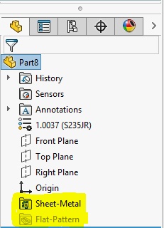

Is there any way to set a fixed K-Factor value? From what I know it looks like it's using the last value used. But If I somehow overwrite it by mistake, it will use a different K-Factor value without me noticing it.
The only success I had was when I created a new part with sheet metal feature and saved it as a part template.
See the picture bellow, but when I then tried to open a part saved as STEP, I got an error message saying: ''The selected template already has a body so cannot be used for this function. Please choose a different template.''
If I delete the sheet metal feature from a part template, the K-Factor will no longer be fixed value.
Thanks in advance for any kind of help.
