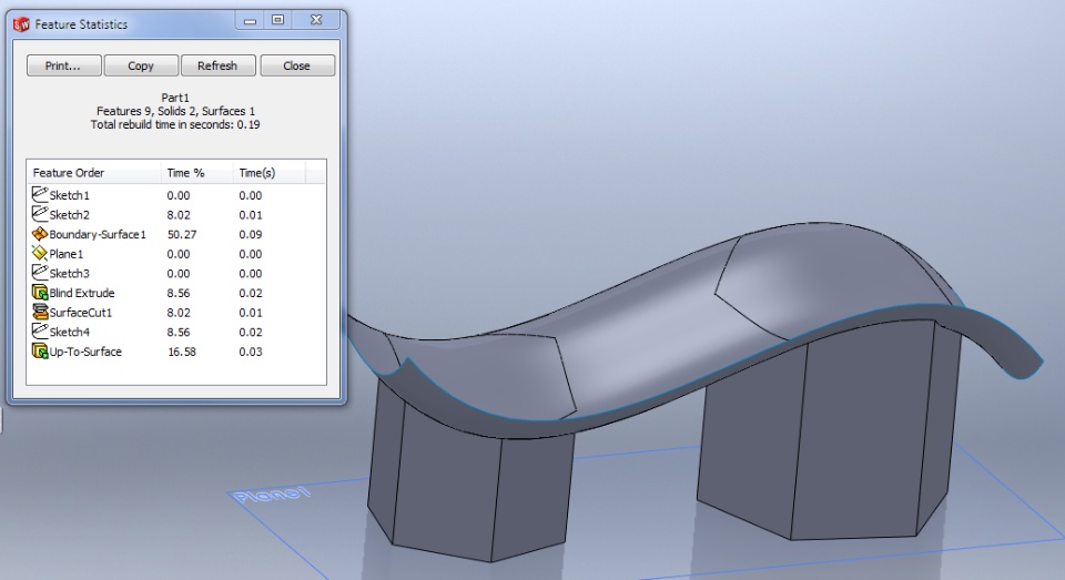

As the research continues, we'll probably ask various questions here and also post more formal surveys. But to get things started, I'd like to follow up on an issue that was raised in the Feature Freeze discussion: "stuck" rebuild flags on part features. Obviously, if a feature near the top of the tree thinks it needs to rebuild all the time, that's going to cause us to build a lot of features needlessly, wasting time. However, a search through our database of customer-reported issues found very few reports of this, and they were pretty obscure situations. So the question is: Do you frequently run into features where the rebuild flag is stuck on (i.e. doesn't go away after rebuilding)? If so, can you post some of these parts (or send them to us privately)?
