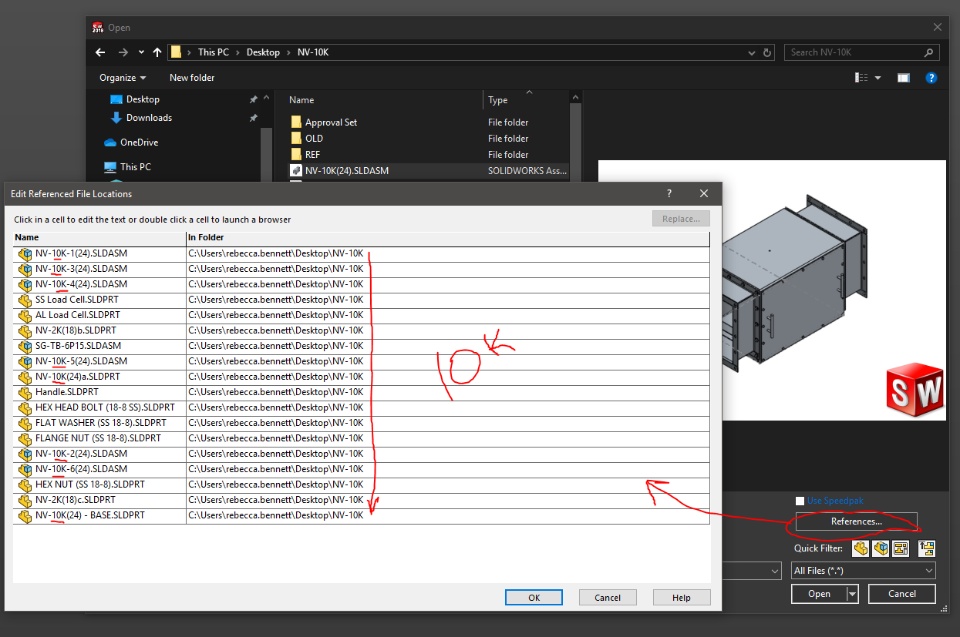

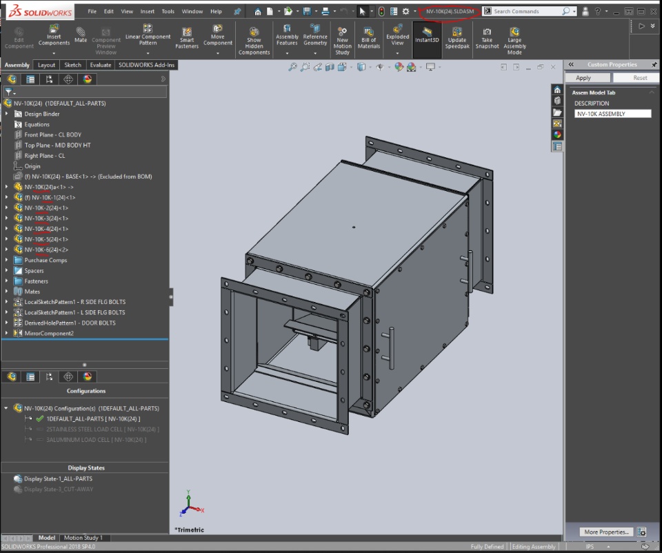

This Pack and Go from a 20K to 10K (in its own folder) had me fighting relationships.

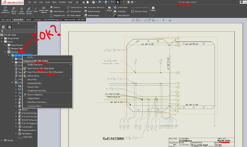

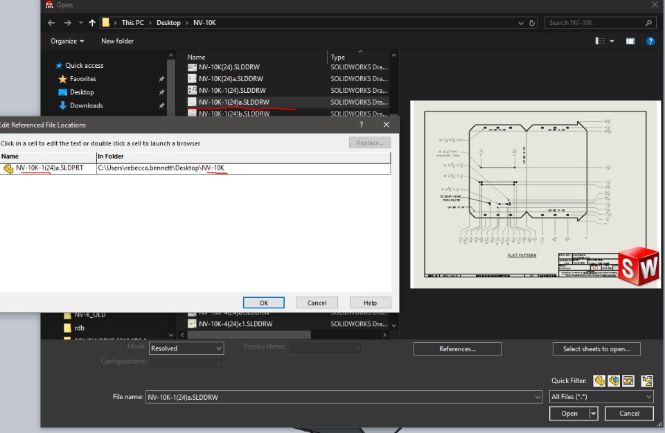

The top model was 10K, the SubAssembly was 10K, the part was 10K.  I double-checked the part drawing relationship was indeed pointed to the 10K, check, it is... But when I open the drawing its referring to the 20K!  Ahhh!  lol xp
I used SolidWorks Explorer to fix the mess.  It was only this and one other part, just random.
