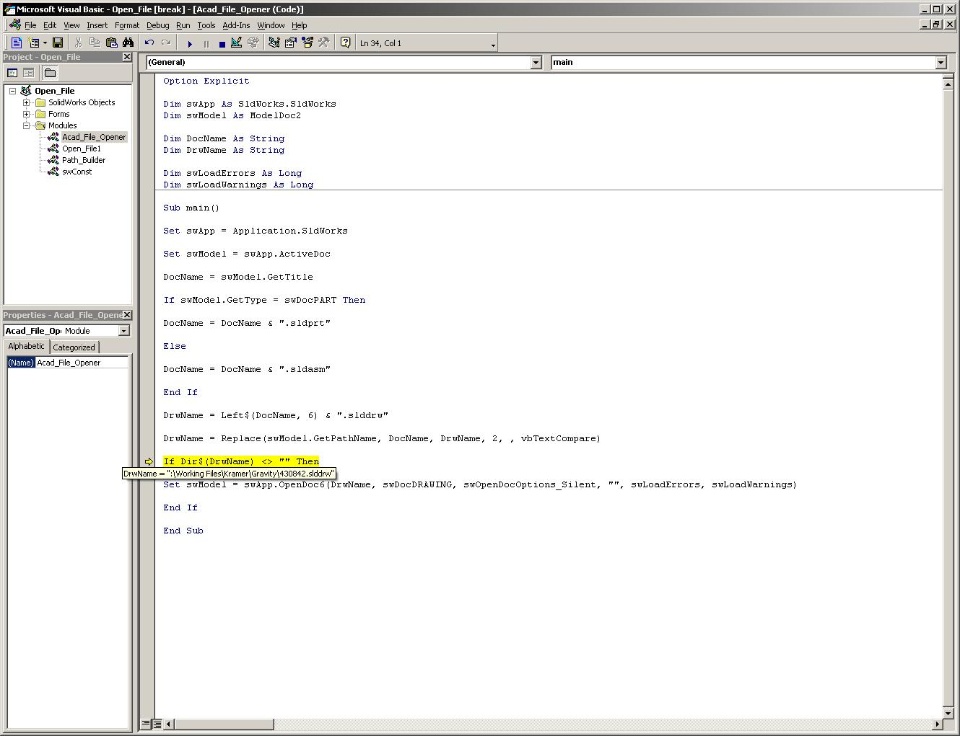

I was wondering if a good samaritan would like to help a APIchallenged individual with creating a Open Drawing macro. I havetried recording a macro but came up with nothing. What I would liketo do is to open a drawing in the same directory from apart/assembly. My thought process is as follows
1. Harvest the active SW File (8 digit #)
2. Remove the last 2 digits making a 6 digit #
3. Open a drawing (if one exists) in the same directory as theoriginal document.
Any help would be greatly appreciated. I have been looking on thenet for examples and other sites, links would be greatlyappreciated too. Thanks
