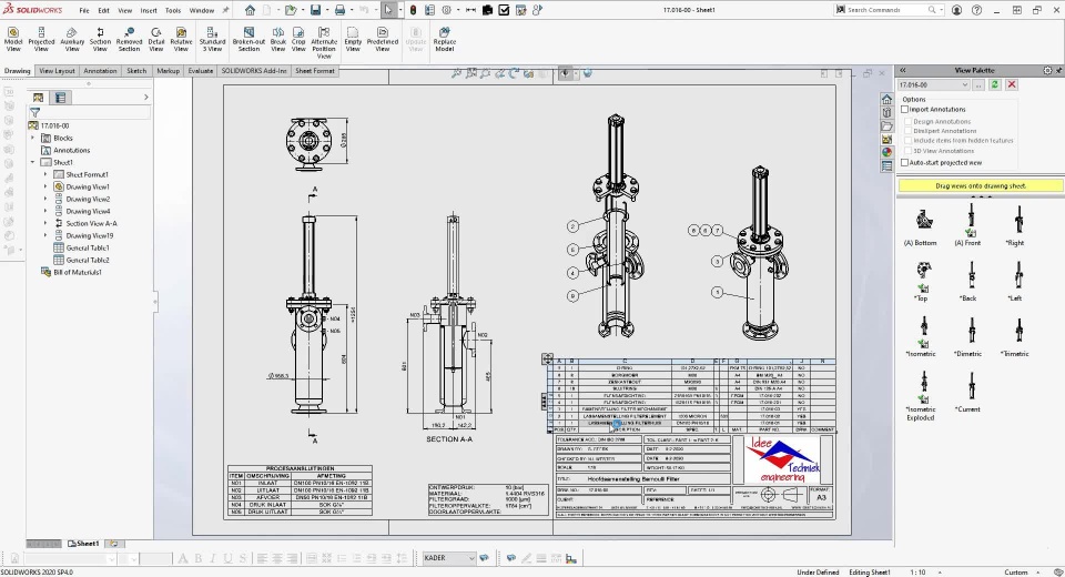

For those who wanna open a drawing directly from another drawing BOM. Stop searching for a solution because this post will give you on. Happy reading, wachting and opening drawings.
Note: The drawings needs to be in the same folder and having the same filename as the part/assembly you want to open from BOM.
Example
Here is a example how it looks like.

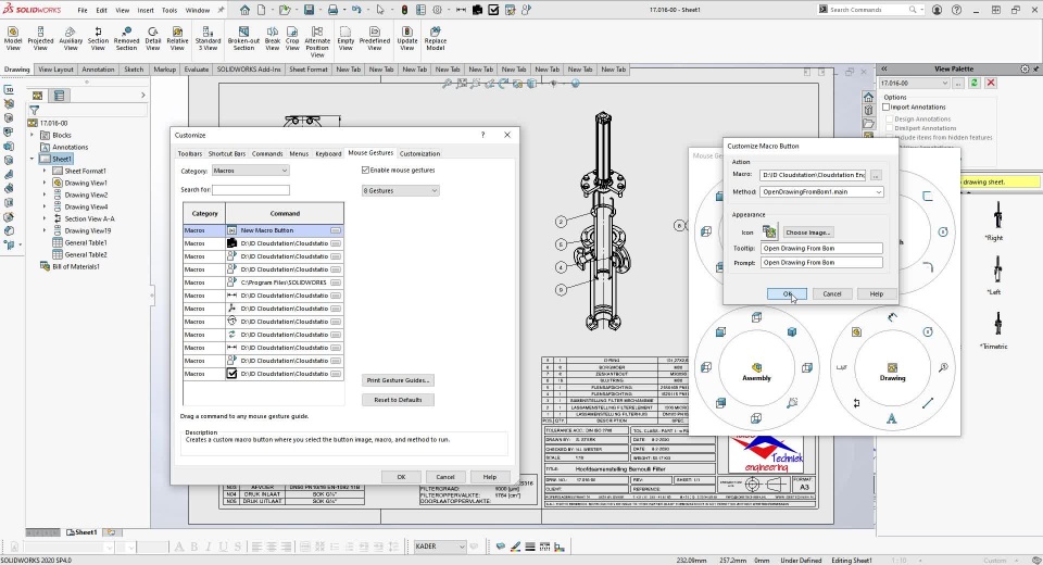

ADD MACRO AS MOUSE GUESTURE (VIDEO)
This video shows how to add the macro as a mouse guesture. So that you can open a drawing from BOM with just a right click swipe.
