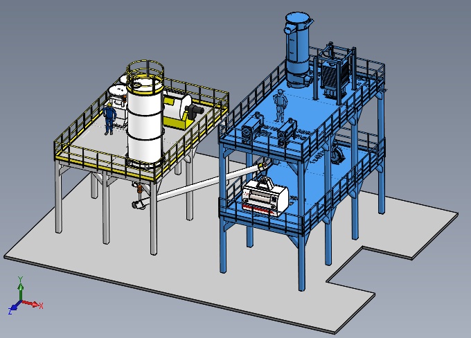

I usually works "layouting" machines and each machine is a sub assembly with a few virtual parts
If I do area select a few of them and Ctrl+click any component entity, I'll just add that entity to the scope of selection

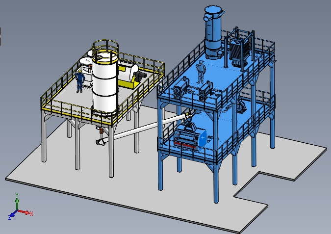

But with the macro running, if I do the same, the sub assembly is deselected:
Might be a silly function when the feature tree has few components, but will make a difference in my daily work, for my assemblies has thousands.
