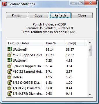

Well my new i7 beast is here and ive got SW2009 SP0 runningok so far. Downloading SP1 as I type but figured I'd run somecomparison benchmarks before I installed it.

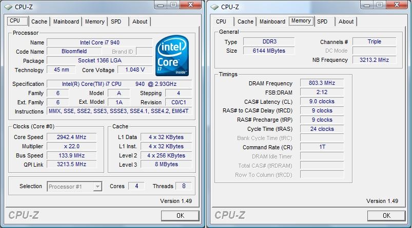

PC Specs are:-
Intel Core i7 940 @ 2.93Ghz
6GB Corsair XMS3 DDR3 1600Mhz RAM
Asus P6T Deluxe motherboard
150GB VelociRaptor 10,000rpm HDD
Windows Vista Business 64
Punch Holder rebuild = 63.88 seconds

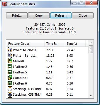

Sheet metal carrier rebuild = 37.89 seconds.
These are straight out the box on a fresh install of SW 2009 SP0with NO overclocking or system tweaking.
I'll see if SP1 has any effect. Then I'll try running the PV360benchmark.
