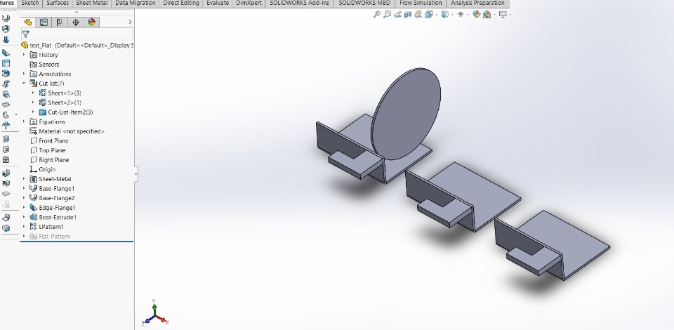

Hello, is there a way to export all metal sheets' flat patterns from a multibody part to separate DXFs with naming from their cultist parameters?
If part has many sheet metals, I want to export them all with name:
Thickness, Partnumber, Material, Quantity.
example: "S-3 P001 AISI304 2Pcs"
Is it possible to make or modify a code to do that?
Example (3 different elements, but only 2 elements are sheets with flat pattern. Can they be exported to their DXF as flat patterns and include bend lines?):

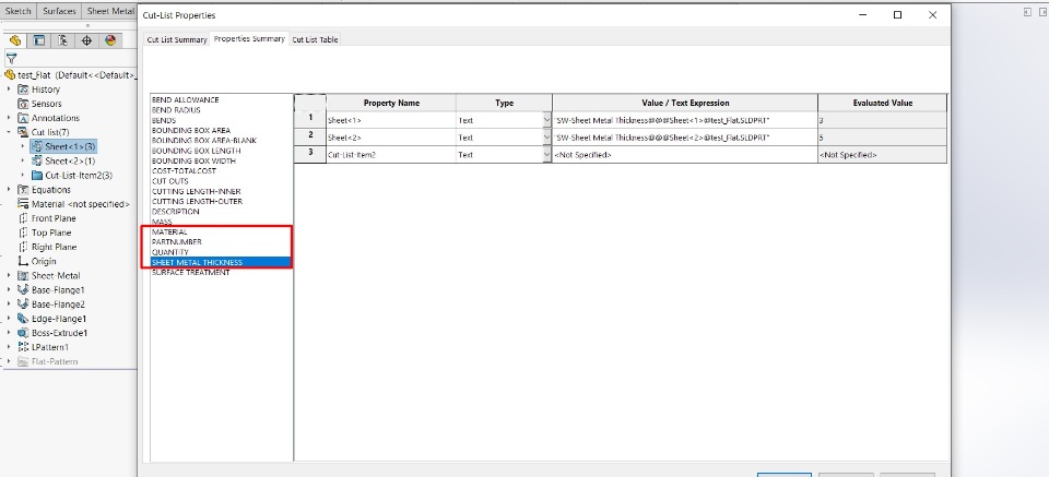

Example 2 (Cultist items Sheet 1 and Sheet 2 have there marked parameters, can they be added to saved DXFs' Filenames respectively?) :
