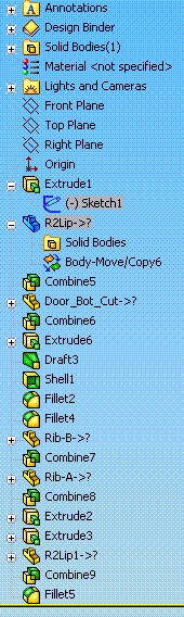

I have brought in IGES parts of each feature from other CADsystem. I started with 1st part, FeatureWorks, createdextrudes, and revolves. Now I have a bunch of
separate parts in SolidWorks . I inserted parts,combined. Hey... look I did great.
Now the problem... To edit these part features, Ieither editin context by Right Mouse Button the part feature, oropenpart.
What I would like to get to is a part that has these insertedpartsas features in 1 part. If I need to edit this part, Ihave tohave saved all of the inserted parts.
So here is the question: How do I moved thoseInsertedparts-combined to an extrude cut. as an example. Inthe end Iwant 1 part file to contain everything
