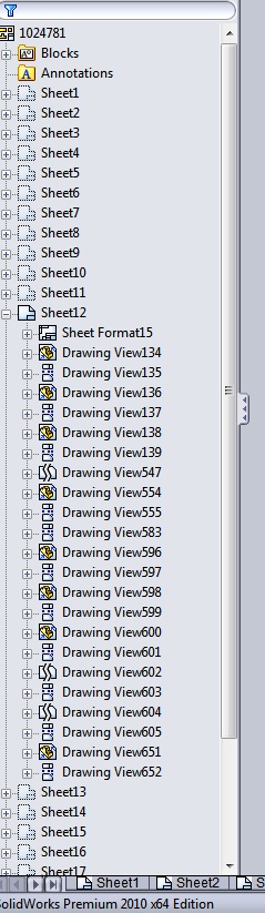

When creating aSection View SW projects the new view in the direction ofthe cut from the parent. On some drawings I need to move the newSection View (the display view) elsewhere on the drawingpage (because I'm out of room). I would like it to behave like aDetail View. Is this possible in SW 2008 SP3?
In other words, I create aSection View to the Right and the new view may only belocated either the RIGHT or LEFT of the section line (projected inline with the parent). I need to move the view BELOW the parent (asopposed to the RIGHT/LEFT) of the parent. Is this possible?
