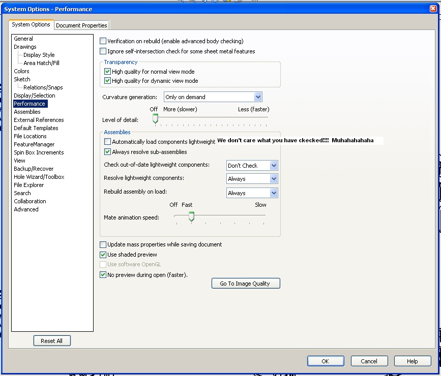

Rant # 1: I've got "large assembly mode" set to 4500components, to prevent SWX opening my assemblies in Lightweightmode.
Why then, is SWX opening all my drawings & assembliessystematically in Lightweight mode - regardless of the number ofcomponents which is way under 4500...
