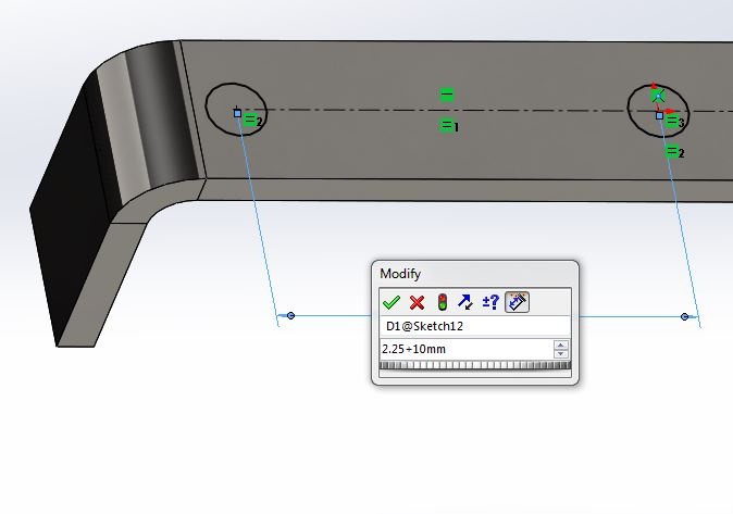

Working with mixed units? I work with mixed units on occasion and don't bother converting, just change the unit on the fly and SW will convert it for you. In the example below my default unit is inches, I am adding 10mm to the number. Not sure if this has been discussed before but some new users may find it helpful.
