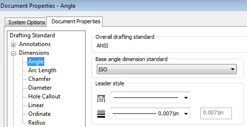

Is anyone else seeing that in SolidWorks 2011, the default templates are using an overall ANSI standard that is full of ISO settings? It doesn't even say "ANSI-modified".

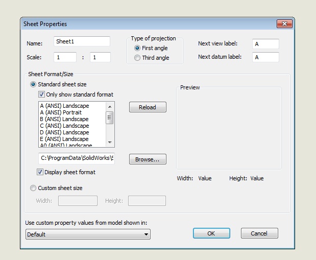

The worst part of it is that in the default template for the drawing, with the Doc Prop Options set to ANSI, you get a First Angle projection drawing. This is 2011 SP4, so the errors have been around a long time, and the people getting screwed are new users, and anyone who relies on a CAD company to be able to deliver usable defaults. 2012 does not appear to have the same problem.
