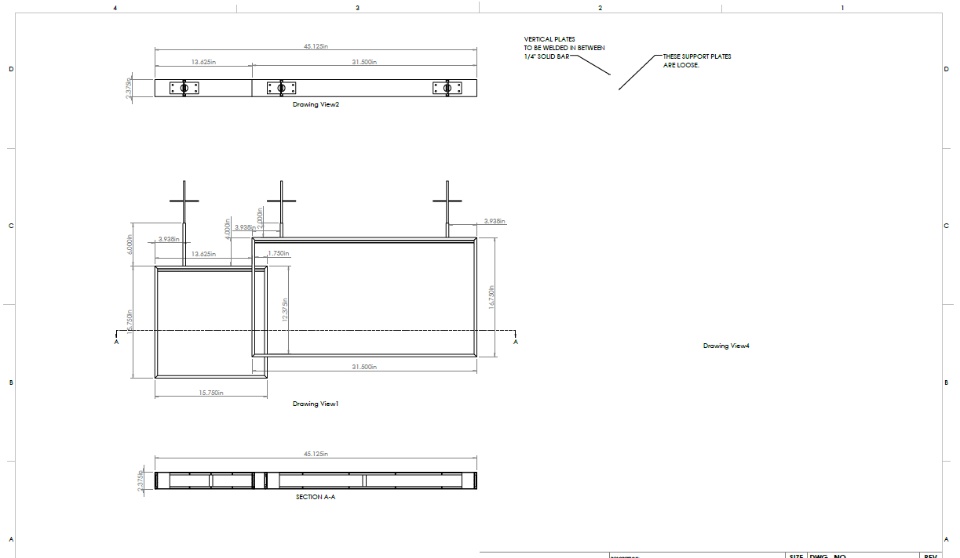

Anyone run across this? Using SW 2021, running the Solidworks task scheduler to convert drawigns to PDF, and some of the views are missing. If I save as from the drawings itself, the drawing views show up. Have the latest tested drivers installed, tried multiple things such as deleting the view, re-creating; recreating the entire drawings..etc.
