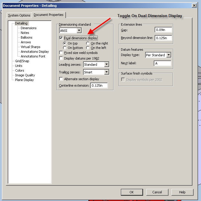

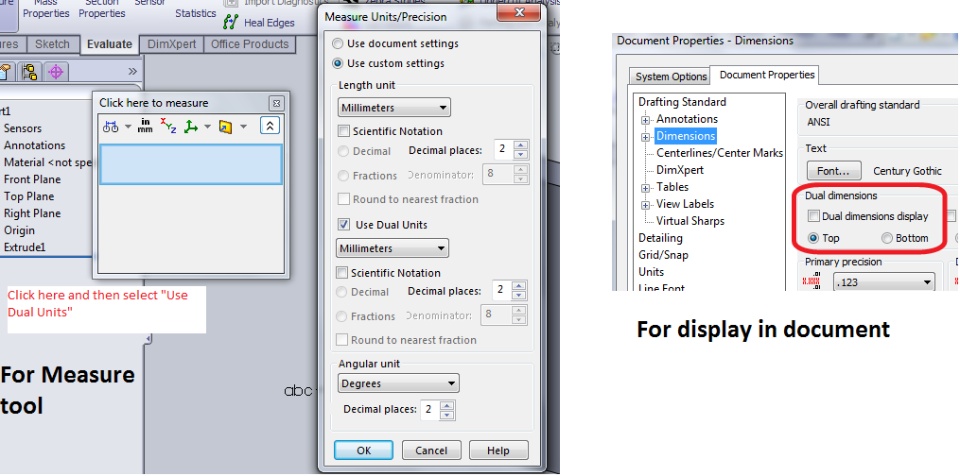

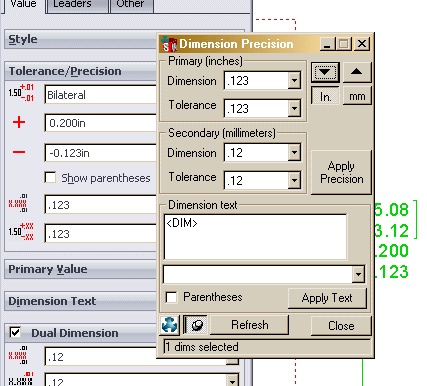

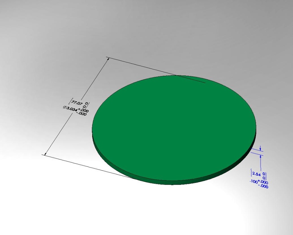

Can't seem to find this out there but has anyone asked forthe ability to measure in two units at the same time. Yeah I wastold over 30 years ago that USA will be metric and it's still an ongoing process. The problem now is when I'm designing, I need towork around two systems of measure all the time. Each time I eitherneed to get out a calculator or keep switching the units formeasure. Not real productive!
