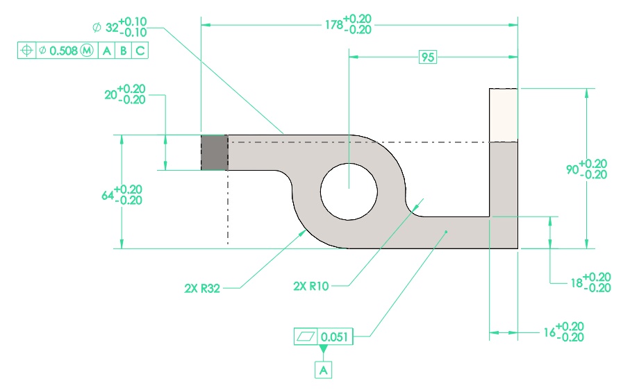

Every dimension you see in the image above is assigned to the Front Annotation View. Additionally, they're all on the same plane.

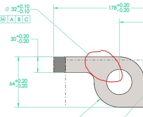

So, my question is this: WHY, when I activate and orient to the Front view, is the leader for the 32mm diameter hole hidden where it touches the model?
