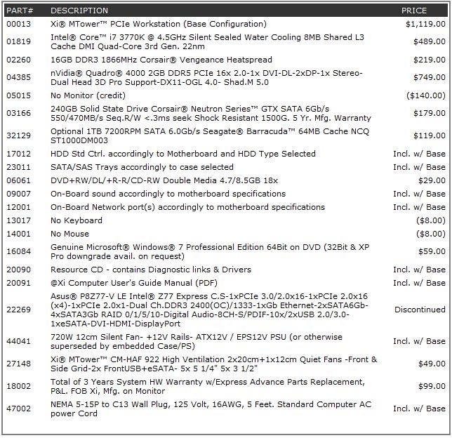

Xi Computers - \\\$2,132
http://www.xicomputer.com/products/mtowersp4.asp
For the first time I'm suggesting Xi. Why? They will give you terrifically fast speeds; they already offer the Core i7-3770K overclocked to 4.6 GHz. This means that it is about 44% faster than the above computer (approximate, based on calculation and not benchmarking). And they give you all the options that HP, Dell, and even Boxx don't. I'm impressed, and I'm even more impressed with their price. For a computer that performs better than the "homebuilt" I have specified below, it is not that much more expensive. If you want a pre-built machine, this is the ticket.
Xi MTowers are: CADalyst! HR & AllStars, PC World Best Buy 2007/2008.
Xi® MTower™ PCIe Workstation
Base Price: \\\$1,119.00
SAVE QUOTE
PART#DESCRIPTION
PRICE
00013Xi® MTower™ PCIe Workstation (Base Configuration)\\\$1,119.00
01819Intel® Core™ i7 3770K @ 4.60GHz Silent Sealed Water Cooling 8MB Shared L3 Cache DMI Quad-Core 22nm\\\$439.00
0225116GB DDR3 @1600MHz Dual Rank Interleave (Dual RAM Channel MoBo only)\\\$199.00
04394AMD® FirePro™ V4800 1GB DDR5 PCIe 1xDVI Dual Link 2x Display Ports Dual Monitor Support\\\$189.00
05015No Monitor (credit)(\\\$140.00)
03147120GB Solid State Drive Corsair® Force Series™ 3 (R2) SATA 6Gb/s 550/520MB/s Seq.R/W SandForce® SF-2200 Ctrl. <.3ms seek Shock Resistant 1500G.\\\$89.00
32112Optional 1TB 7200RPM SATA 6.0Gb/s 64MB Cache 4.2ms Latency (no RAID)\\\$129.00
17012HD Ctrl. According To Motherboard and HD Type SelectedIncl. w/ Base
23011SATA/SAS Trays accordingly to case selectedIncl. w/ Base
06061DVD+RW/DL/+R-R/CD-RW Double Media 4.7/8.5GB 18x\\\$49.00
09007On-Board sound as per selected motherboard specificationsIncl. w/ Base
12001On-Board Network accordingly to motherboard selectedIncl. w/ Base
13001Logitech® Black Windows KeyboardIncl. w/ Base
14010Logitech® 2+ Wheel Mouse Black OpticalIncl. w/ Base
16084Genuine Microsoft® Windows® 7 Professional Edition 64Bit on DVD (32Bit & XP Pro downgrade avail. on request)\\\$59.00
22261Asus® P8Z68-V LE Intel® Z68 Express C.S.-2xPCIe 1x16x1x4x-2xPCIe 1x-3xPCI-Dual Ch.DDR3 2200/1333-1GbLAN-2xSATA6Gb-4xSATA3Gb-1xeSATA6Gb-RAID 0/1/5/10-HD-Audio-8CH-S/PDIF-12/4xUSB2.0/3.0-1xDVI/HDMI/DP-(No OC)Incl. w/ Base
44038650W Cooler Master™ GX Series Ultra-Quiet BB 12cm Fan 80%+ Bronze Efficiency-99% PFC UL (or otherwise superceded by embedded Case/PS)Incl. w/ Base
18001Standard Xi Warranty w/Express Advance Parts Replacement, One Year on System, Mfg. on MonitorIncl. w/ Base
27157Xi® MTower™ CM-Elite™ 430 2x12cm Quiet Fans-Front Grid-2x Front USB- 3x 5 1/4" 7x 3 1/2" (No O.C)Incl. w/ Base
Sub Total:
\\\$2,132.00
Wow. A SSD primary, and reasonably priced 1TB secondary drive.
4.6 GHz Core i7-3770K. This is the fastest computer you can purchase for SolidWorks (that I know of).
The only thing they missed is they don't offer the ATI FirePro v4900. Get either the v4800 or the v5900. The v4800 should be more than enough for most users.
Can't remember everything? Just ask for Quote #274818, that is this system.
Note that this motherboard will not utilize PCI-E 3.0, but that firepro video card is only PCI-E 2.0 anyway. This is just a drawback for future video card upgrades. I still woudln't hesitate.
