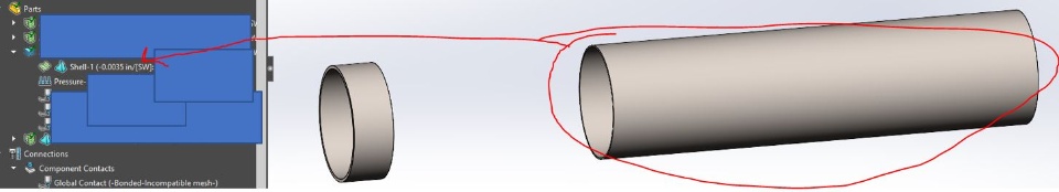

I am running a static pressure analysis in Solidworks Simulation. I have a thin walled element that I want to treat as a shell element, because otherwise my mesh would have very small elements (.002 or so).
I created the shell element by "Define Shell by Selected Faces". I offset the shell in the correct direction at the correct thickness.
When I run the analysis however, I am getting excessive displacements error and it complains that you cannot use excessive displacements with shell elements.
I know (from testing, and other hand calcs) that I should not be getting excessive displacements and I am pretty sure that it is my contact sets that are the problem. I have created my contact sets a couple of ways:
1. Just leaving the global contact
2. Creating my own contact sets by selecting the shell face (also tried the edge) and the solid face it should connect to
3. Trying the auto find contact sets
4. Trying the auto find contact sets with the "Find shell elements" option
So far I am still getting the excessive displacement error, I also decreased my pressure to basically 0 to make sure it was not an actual large displacement.
