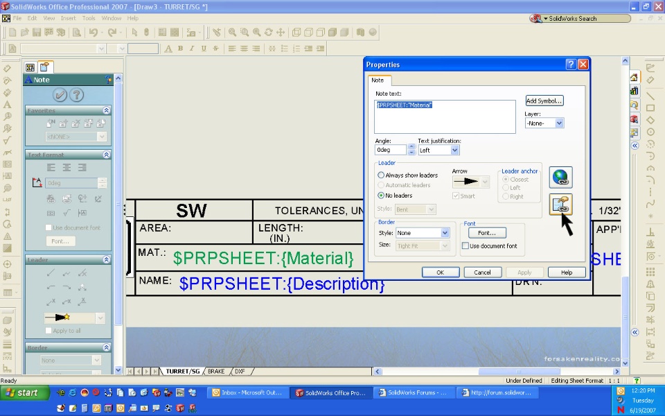

There is probably a real simple way to accomplish this, buthowdo you use the material called out in the part file in a cellinthe title block. (e.g. the model is ABS chosen from thematerialproperties and the title block has a call out for materialand Iwant to retrieve "ABS" from the part file). If I changethematerial in the part, it will automatically update thedrawing.Thanks, Dale
