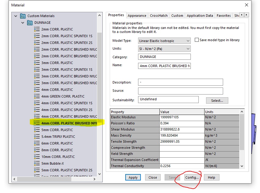

Material Change doesn't change Flat Pattern material
This has been happening a lot lately. I pack and go from one project to another because they are similar but material is different. I go in and change the material but it doesn't change the flat pattern material by default. I have to click config and hit okay again to apply the material change on all configurations. This leads me problems in the drawing if I miss to do this because BOM pulls the material info from the flat pattern somehow. Is there a setting somewhere or macro for this or am I doing something wrong?
