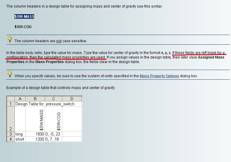

Hi,
i am having trouble getting the mass to show up in the design tablefor the different configs. i believe i have followed tehinstructions as shown here, as cut and pasted from teh Sw helpfile. however, the design cells still remain blank, even thoughaccording to this, they should update with each config...
any suggestions?
thanks,
