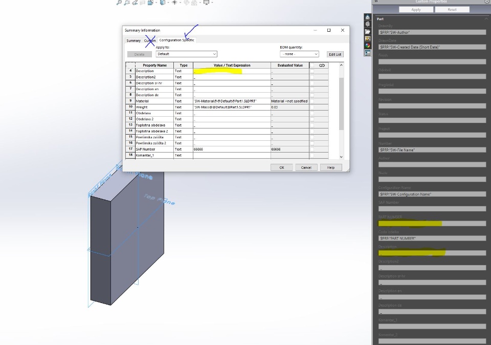

2. I want to fill configuration costume properties from exel detabase.
I would like the macro  find in Excel the corresponding properties (Description, PART NUMBER ...) according to the file name (name of part). However, they must be entered at the configuration level (cofiguration specific).
like:
\\\$PRPSHEET:{Description} for Description
This is the code that works for me. but I don't know how I need to fix it to make it work at the configuration level

Excel, test parts, macro..... everything is attached in "macro.rar"
