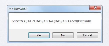

If macro found a drawing then it would prompt user if he/she wants to export PDF & DWG both or only DWG.

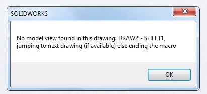

If there is no model view found in a drawing, macro would skip that drawing and prompt the user.
