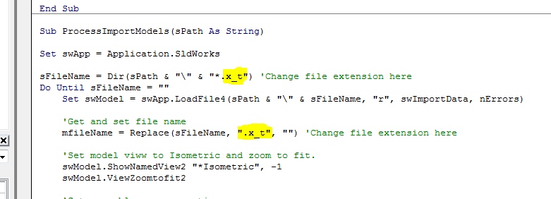

Attached is a macro to import all parasolid files from the specified folders and sub folders and then save them as part file in same location. In case the parasolid is of assembly, then it is saved as Part as well with exterior faces option. The macro can be modified to set a different location for saving the file and saving assembly as assembly instead of part.
In case you want to use the macro for other formats like STEP, IGES, then changes the file extension in these two lines in the macro.
