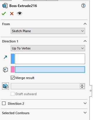

I'm trying to insert a pre-made library feature. I followed the code given in this example here. The location point is where the library feature will be placed. The problem that I am encountering is that my library definition does not see the endpoint I selected for the Up To Vertex. The AxisPt1 is not being selected for the definition update.

AxisPt1.Select True   'ending of library feature
