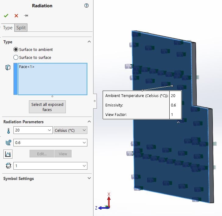

It is desired to simulate that the front surface is currently at a maximum ambient temperature ...
It is desired to simulate that the front surface is currently at a maximum ambient temperature of 20 C while receiving Solar Radiation and Assuming an absorptivity for Polished Al-6061 of 0.6. QUESTION: WHATS DOES SW INTERPRET WHEN ASSIGNING A RADIATION T
