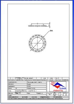

Solidworks drawing:

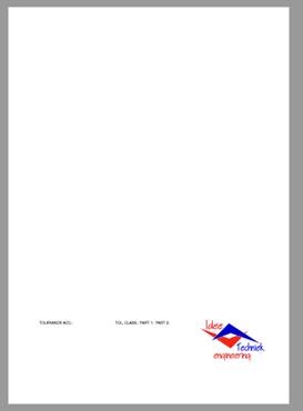

Failed PDF output:
I can save another drawing as a PDF without any problems by restarting Solidwork, but only once. So I have to restart Solidworks every time to save a drawing to pdf. Pretty time-consuming.
