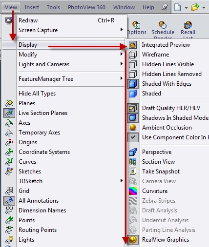

In SolidWorks 2013, the possible viewport render modes are standard OpenGL, RealView, and PhotoView 360 Integrated Preview. Our reason for introducing RealView Plus in SolidWorks 2014 is to offer users a real time working viewport that more closely matches what you can expect to see in your PhotoView 360 renders than RealView does. RealView Plus is meant to be used the same way you use RealView. You can model your part from scratch, move components, apply and modify appearances, and see your part rendered photo-realistically, all in one view mode. Ray tracing introduces new effects, like reflection of other parts in the scene and refraction, which were not possible in RealView. For a demonstration of RealView Plus, please see the video attached to this post.

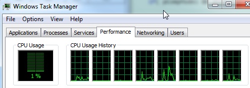

- You must have at least six logical cores in your CPU. The easiest way to know how many logical cores you have is to check how many CPU Usage History graphs you have in Task Manager:
I have a four-core CPU with Hyper Threading enabled. The screen shot above shows I have eight logical cores.
- In the future, you will be able to run RealView Plus if you have an RTU from Caustic Graphics even if you don’t meet the CPU requirement.

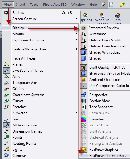

Registry Entry
To enable the UI entry for RealView Plus, you need to run a registry file. See the files attached to this post:
RealViewPlus_ON.reg - Enables the UI control for RealView Plus
RealViewPlus_OFF.reg: - Disables the UI control for RealView Plus
