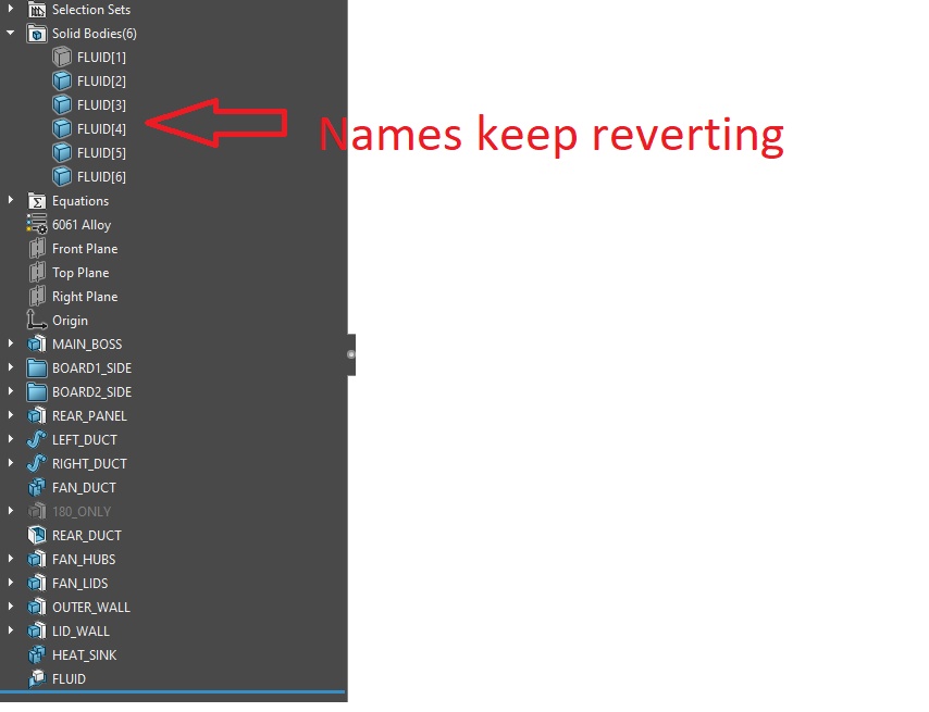

Intersect Body Names
I generally use the intersect command to create solid bodies for internal volumes (helpful w/ CFD mesh refinement). One rather annoying issue that I've been running into lately is keeping track of all the different solid body names. I'll generally assign names to each of my solid bodies as my model progresses down the tree (again, helpful for CFD purposes).
After using the intersect command (usually the last feature in my tree), all of my body names disappear & new bodies show up referencing the intersect feature name. Very annoying, but manageable -- I just rename all the bodies back to the way I had them. This is where my real greivance kicks in -- if I drag the "insert here" slider up in the model tree (e.g. editing an existing feature) & then drag the slider back down when done, all of my updated post-intersect model names disappear & revert back to itterations of the feature name. Is this a bug or is there something I'm doing wrong? This pretty much makes it impossible to name my solid bodies reliably.
