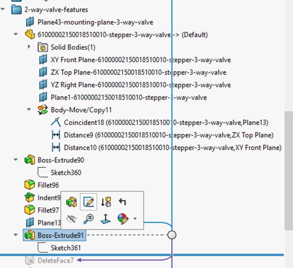

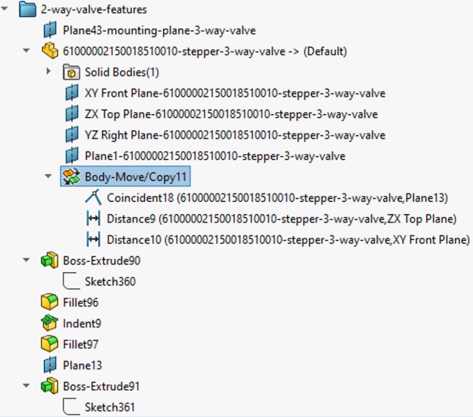

Here is what the feature looks like

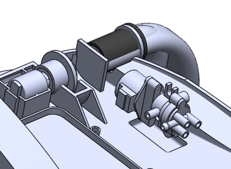

Here is the Part positioned in my model ( the small valve with ports)
Now when I edit this feature (RMB on below in my tree)  AFTER the inserted part feature (Boss-Extrude91)...

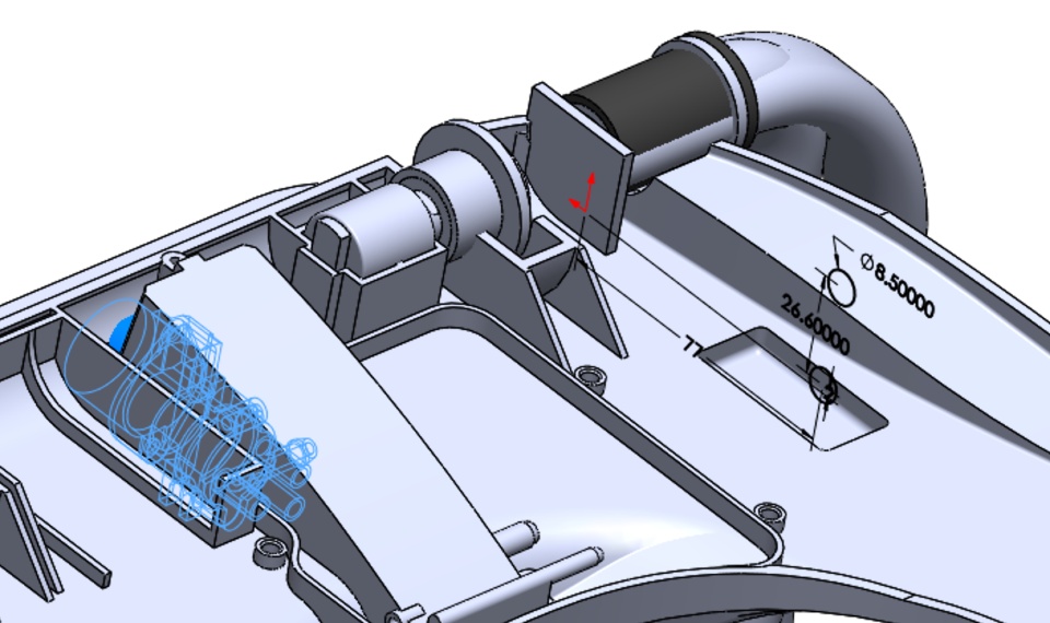

The insert part moves back to its default insert position (blue highlighted ) as if the constraints are not applied or rebuilt.
Now keep in mind that the insert part is not a child or parent of the sketch feature that I'm editing above. As a workaround I've tried inserting the part without the move/copy option and then did a separated move/copy feature on it after the inserted-part feature - to no avail, I still get the same behavior. This tells me the bug is with the Move/copy feature and not Insert-Part feature.
