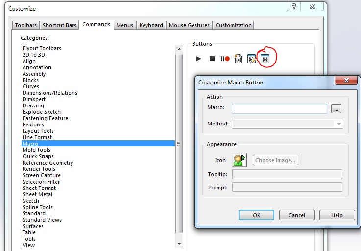

I wanted to modify the behaviour by holding down a key when starting the command.
Add the macro to a toolbar with a macro button.

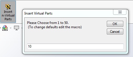

When starting the command holding down shift will prompt for a number
or just use the number pad directly - 0 counts as 10.
eg result of holding down 5
With no key pressed it inserts a default value hard coded into the macro - 10
