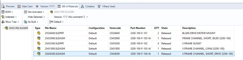

Indented BOM not detailing levels in Bill of Materials tab for assemblies
For some reason, I can't get indented BOMs to drill down any further than the top level. I've tried checking out, saving, and checking back in both the top level and sub-levels making sure to set lightweight to resolved to no avail. Am I missing something here?
