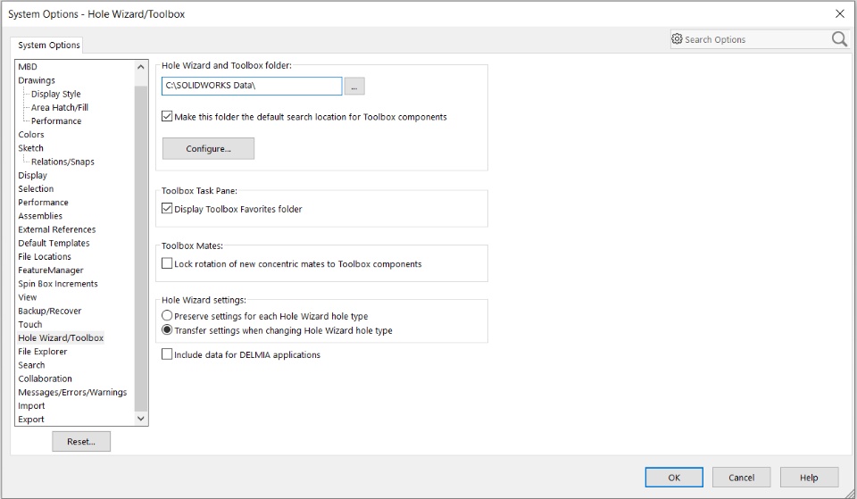

As title says, I need help resolving a SW Toolbox that is completely empty after installation (and subsequent reinstall). I run SOLIDWORKS Professional 2021 SP2.0 on a Windows 10 PC. My VAR has suggested a few things as described below but we're still trying to figure this out.

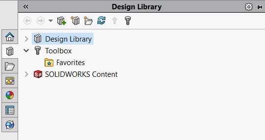

  • In SW, only the "Favorites" folder is visible under Design Library --> Toolbox (pictured below).
  • Hole Wizard and Toolbox folder is set to C:\\SOLIDWORKS Data in System Options (pictured below).

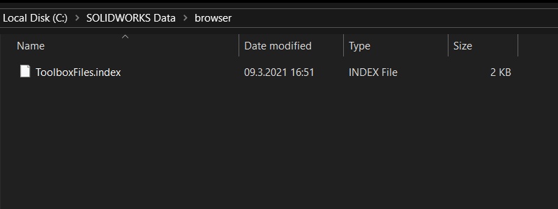

  • C:\\SOLIDWORKS Data\\browser only contains the file ToolboxFiles.index but is otherwise empty (pictured below).

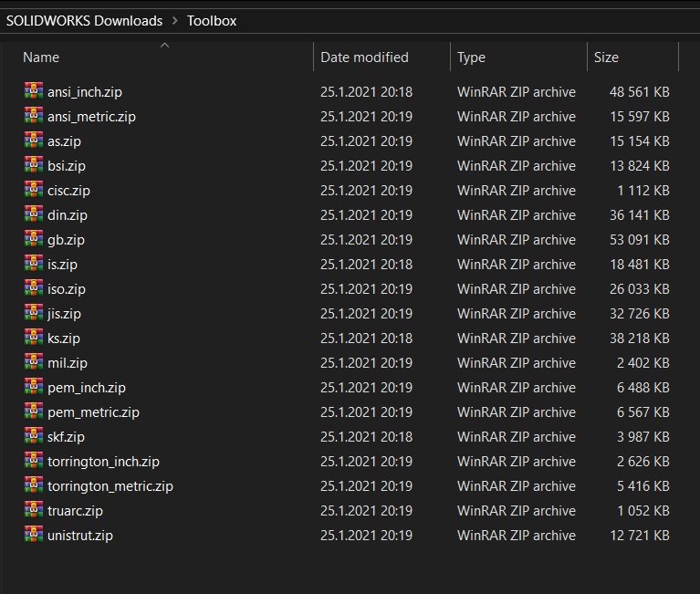

    • The Toolbox folder in the downloaded install files contains all the standards in compressed zip archives (pictured below).
