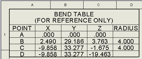

Here's an example of the two scenarios.
With the "Enhanced graphics performance" option Checked:
With the "Enhanced graphics performance" option Unchecked:
As you can see (hopefully), the text is much sharper and crisp with the option unchecked.
