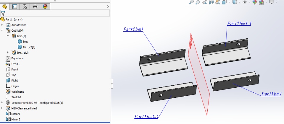

I found only one acceptable way to mirror weldment - mirroring it inside weldment file. Why?

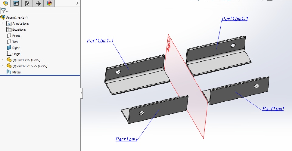

I don`t use assembly mirror feature because of these two problems
Mirroring by part mirror feature gives correct result
but part numbers are incorrect because they link to original ones and there is no way to link cut-list property to cut-list property of original part.
Also there is no way to add suffix or prefix to some (myPartNumber) cut-list property as it possile for file name in case of assembly mirror feature.
So, I found only one way - mirroring of weldment inside weldment gives right result
So, to mirror weldment I use mirrored configuration "-1" and can use it for mirrored assembly.
At the same time now I can create only one drawing named "Part1.bm1" for part "Part1.bm1" and it`s mirrored configuration "Part1.bm1-1"
