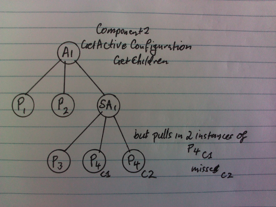

Hello, this is probably a beginners mistake but I am trying to traverse an assembly and get the right configuration of the parts to do tessellation of each. Unfortunately I am missing something because I am getting 2 instances of the same part configuration even though for each instance of the part the configs are different. Can someone help me discover both part configs please.
Should I use ConfigurationManager instead? atm it seems to return the last saved state for both??
sorry about the large jpg - android camera
EDIT: This question was been answered by Bnaya Livne in the next post. Thanks.
