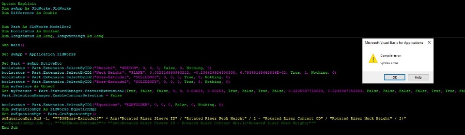

   I am trying to add an equation for a boss extrude dimension but it is showing syntax error like this -
 Can someone please help me out?

swEquationMgr.Add -1, """D3@Boss-Extrude10"" = Atn("Rotated Riser Sleeve ID" / "Rotated Riser Neck Height" / 2 - "Rotated Riser Contact OD" / "Rotated Riser Neck Height" / 2)"
