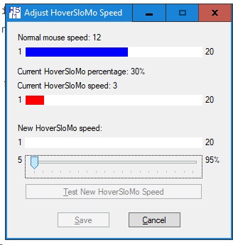

To set your percentage, select the "Adjust HoverSloMo Speed" menu and this dialog displays:

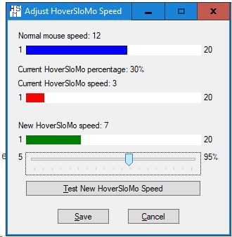

Drag the new speed slider and the Test and Save buttons are enabled:
Click the Test button to get an idea of the mouse speed at the slider's current position.
To reset your speed to normal: 1) Drag the slider to new position. 2) Click Save. 3) Click Cancel.
When you click Save, the new speed is used for the current sessions and is written to the ini file for later recall.
