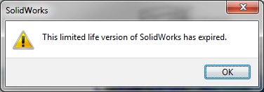

We are aware of an issue where those users of the SolidWorks Student Design Kit (SDK) 2013-2014 who should still be entitled to use it, are seeing the following error message when launching SolidWorks after December 31 2013.
We apologize for any inconvenience this problem has caused, and have developed a hotfix to correct it.

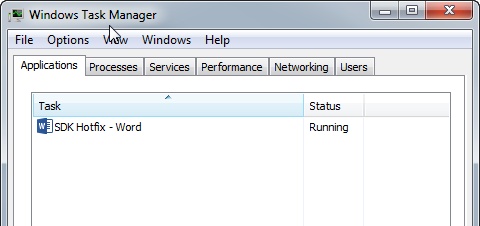

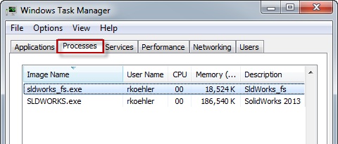

Verify in the Task Manager that sldworks.exe and sldworks_fs.exe processes aren’t running. To do this, open your Task Manager by pressing “Ctrl + Alt + Delete” at the same time and select Start Task Manager. You will then see the window below.
Next select the 2nd tab in the Task Manager labeled Processes
If either of the processes listed above are still running then select it and click “End Process”.

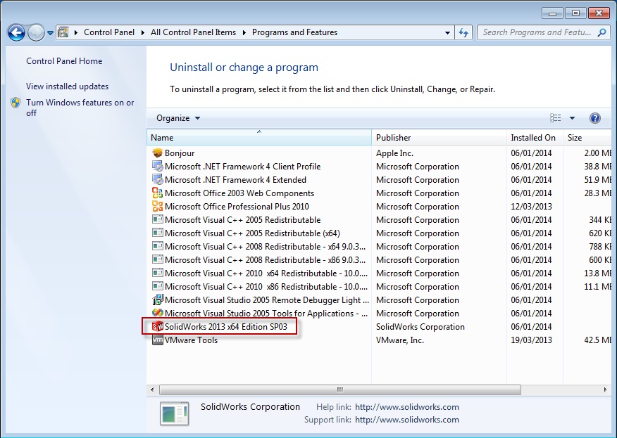

2. Determine your SolidWorks version and service pack
To do this, open your Windows Control Panel from the Start Menu, select the "Programs and Features" item, then locate SolidWorks in the list of programs. Make a note of the version and service pack number, then close the Control Panel window without making any changes.
SolidWorks 2013 [x64 Edition] SP02 = Version:2013, Service pack:02
SolidWorks 2013 [x64 Edition] SP03 = Version:2013, Service pack:03

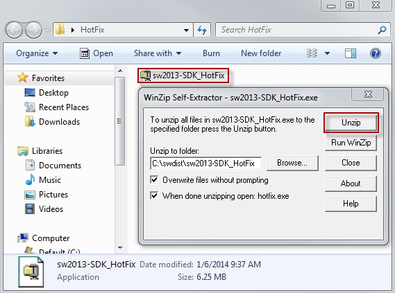

4. Run the hotfix
Double-click on the hotfix sw201x_SP0x-SDK_HotFix.exe. A WinZip Self-Extractor should appear. Click “Unzip”.
A pop-up will appear confirming that the files have been extracted. Click “OK”.
A User Account Control pop-up will appear. Click “Yes”.
If the hotfix has been installed correctly you will see the message: "Your product(s) have been successfully patched."
SolidWorks Student Design Kit (SDK) 2013-2014 will now open and run properly.

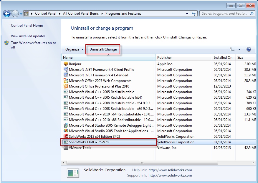

Hotfix removal instructions
The hotfix must be removed before installing any newer versions of the SDK or Student Edition in the future.
Before removing the HotFix, please be sure to close any running sessions of SolidWorks.
Open your Windows Control Panel from the Start Menu, select the "Programs and Features" item, then locate the item SolidWorks Hotfix 752978 and click Uninstall.
